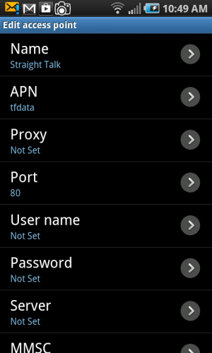

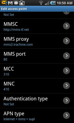

If you post your screenshots of your apn settings i can confirm if they are correct. If they are then there is NOTHING YOU CAN DO EXCEPT GET A 2ND SIM OR WAIT UNTIL YOUR NEXT BILL CYCLE. The people who can't send and receive probably have an apn setting issue.

APN looks good. only difference is mine under" apn type" its set to Not Set.

These are setting that work on my att note 3 on st only I have 1 addition
Vpn type defualt,mms,supl,hipri,fota
After this was inserted then rebooted it worked my att apn is still on phone also
Copied from my e-mail from Straight Talk. Triple check your settings as I had a minor typo that was preventing mine from working correctly.
APN PROGRAMMING FOR MOST PHONE MODELS:
Once you have reached your phone's APN (Access Point Name) settings, create a new APN with the following values.
1. APN Name: Straight Talk
2. APN: tfdata
3. Port: 80
4. MMSC: http://mms-tf.net
5. MMS Proxy: mms3.tracfone.com
6. MMS Port: 80

I added
Vpn type default,mms,supl,hipri,fota
And it works my att note 3 st recieves and sends mms
