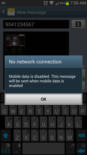

Even though I get the below error message on my Sprint Galaxy S3 running Jelly Bean with mobile data turned off it still send the MMS through WiFi without any issues.
Sent from my SPH-L710 using Tapatalk 2
I wonder if people are having this issue due to using the stock app as well.
I used a third party one (ChompSMS) and I don't receive the error your seeing.
