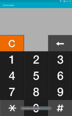

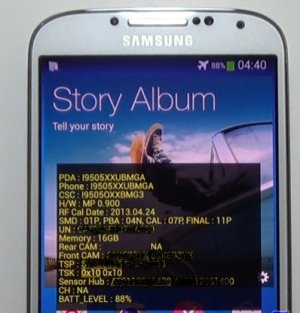

Do you mean Factory Mode which always display information of the mainboard ?
This is an example of a tablet in Factory Mode

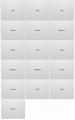

No, it is more than Factory Mode. Yes, it does have that display information, but that is about it except for testing of components (like left and right speakers, front and rear camera, IR sensor, colors, brightness, touchscreen, etc.) So it is just a test mode to test all of the components of the tablet and nothing else.
If you do a search here on AndroidCentral for "How to uncover and use the hidden Service menu on the Galaxy" you will see the menu I am in ( I would post a link to it but I am a new member with less than 10 posts)
I don't understand your question, but exit the testing screen you just hit the back button until you exit the Factory Mode and Testing Menu.
This is the Testing Menu, is this the one you cannot exit ?
Hit back button until you see this
Just hit back until getting back to the system
