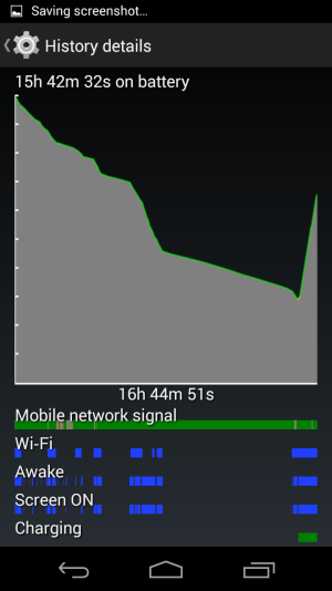

Thers is very little usage that is why the awake bars are not there. How much the device has been used can be gauged from the fact that the screen was hardly on. You hardly used your device
Also do you face the problem of very slow charging? You mentioned in one of your posts, where you said it tool 4.5 hrs. Is motorola giving us defective phones?
wow Thats a lot of usage.
From the graph its showing that you have Wifi on.
Also what are the two symbols on the left. One that looks like an antenna and the second one that is a circle that says 72.
Another thing is its showing that the phone is "AWAKE" for almost the entire day. Looks like there is an App running in the background keeping the phone awake and draining the battery overnight.

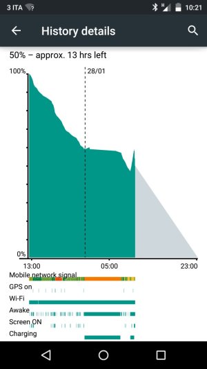

Hi there, I have a similar issue, a very long recharging time (4 hrs) and a strange happening that has started a ouple of days ago. I post my battery screen I am sure that everyone will understand...
Basically at night when I PLUG IN the phone and let it do it's recharging business, it simply does not recharge. Actually it drains battery while plugged in. I will check my cables tonight (could be that there is something wrong in the miniusb cable), but the funny story is that the phone seems to be awake all the time, as if something is keeping it up (already checked, the "stay awake when charging" is not ticked).
