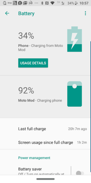

Here's what you should see in Settings->Battery
Thanks guys. I don't have a bumper case on yet. I never saw anything like what you are showing. I reread bill-e post, so I turned my phone off and put the battery on while it was off (last time I turned the phone back on before I put it on). Attached battery and have not turned phone back on. Plugged it in and now there are 2 circles showing charging levels. That must have been the trick. I'll see in a few hours after it charges if this did the trick.

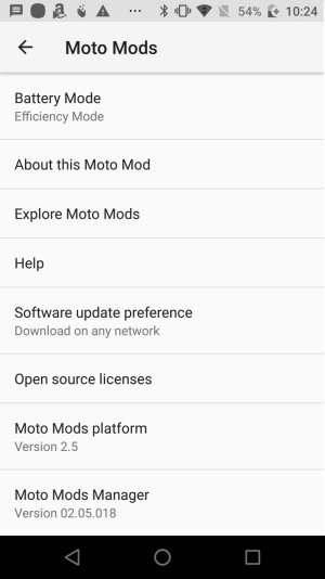

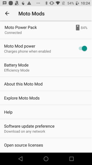

babracmmm, just one more thing that might be helpful if the new mod gives you issues. This is from a Z Force with a working power mod.
