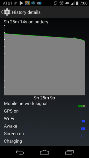

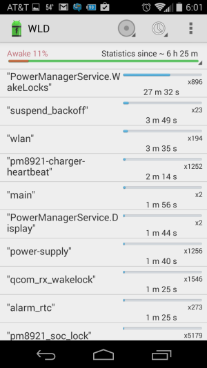

Using some tweaks suggested here as well as running down some apps running in the background, I got my battery to discharge ~1.5%/hour with 89% deep sleep over 6.5 hours. Originally it would discharge ~0.4%/hour overnight and get deep sleep in the high 90%s. Android OS consumed most of the battery life, but I forgot to screenshot it. Here are some screen shots of last night with "Location" and "Wifi" on after a full charge, then a reset.
Can I feasibly get my battery back down below 1%/hour, or should I try a factory reset or try exchanging for a new phone (I should still be under factory warranty after 5 months, right? )?

View attachment 111770 View attachment 111769
Extrapolate on "Location On". What type of accuracy and location reporting as well as history on/off?
You definitely have some partial wakelocks that could be consistent with high location accuracy as well as location reporting and history turned on. If that's the case, then there may not be much you can trim off with those settings on unless your can narrow down a specific app wanting regular updates and squashing it out. If it's the OS for sure then that's probably the best you'll get without turning all of it off. You could always shut sync off for a night or two just to see if it makes a difference.

A few days later and my phone hovered under 1% /hour in airplane mode. The battery went from about 89% to 82% over 8.5 hours which comes out at 0.8%/hour, but I don't have exact numbers because I'm not sure what the batter was at when I turned in. KWKSLVR guessed that the Location Settings could contribute to my wakelocks; he may be right as it looks like going into Airplane mode drastically reduced my wakelocks.
Note: Also, I didn't screenshot until after I had already started downloading and listening to podcasts.
