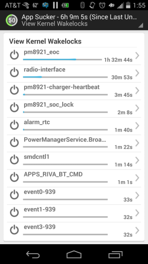

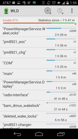

I'm not the OP, but I'm having substantial wakelock problems (sounds like the OP's problem) over the last few days on my Moto X AT&T 4.4.2. Last week I cleared my cache with no noticeable difference. Apparently, something called "Power Managers Services" is waking up my kernal a lot. Can you guys help me decipher a few battery stat screen shots that make little sense to me?
Wakelock Detectors stats from last week

100% - 56% overnight last night and the GSam wakelock stats from the same night

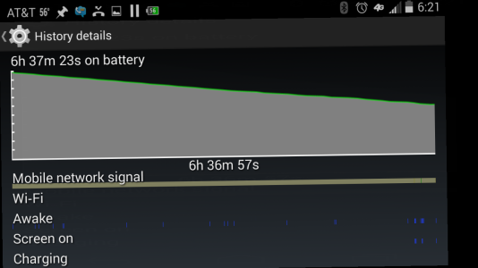

I can use my device the same way two day in a row, one day on wifi and the other day off and the difference in battery life is pretty noticeable. There are a lot of variables.
Maybe ive missed this but even when I have wifi turned off I still have the blue bar showing wifi time on in the battery settings. my gsam battery monitor shows that the wifi is off and has not been used. I just cant figure out for the life of me why the blue bar is still there?
I don't believe stats are reset until you recharge the phone completely. At least that's the way it was when I had my S3. So...IF you used wifi at all before recharging your phone the usage will still show up.
If you go to Wifi - Advanced, there is an option called "Scanning Always Available" in which Google location uses Wifi even if it's turned off. If it's checked, your battery stats will show a solid continuous blue bar of Wifi usage.
