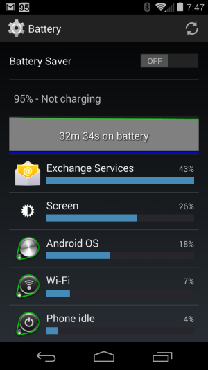

Day 9 with Moto X...first 3 were amazing. Then for some reason the phone got hot and the battery drained quickly. Saw that Exchange Services was doing something so I did a little research here and elsewhere and deleted my Exchange account and re-added it. All was fine until the same thing happened yesterday. I can't keep deleting and adding my Exchange account every 3 days.

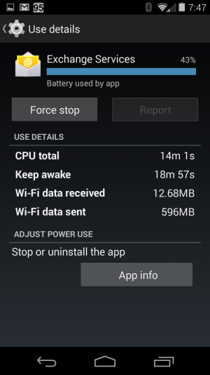

1. the % is not % of battery but a % of usage. if you use little/NO apps during X period of time - of course a large % of usage will be Exchange running in the background.
2. we need to see an entire day of usage - and full details. 32 minutes at 95% Battery usage tells us nothing.
3. how far back in days for old email do you have Exchange Email syncing in settings? 30 Days or less? the lower number will be less toll on battery and data.
4. Exchange does not appear to be pushing much that data in that 32 minute snapshot. ~14MB Sent and Received?

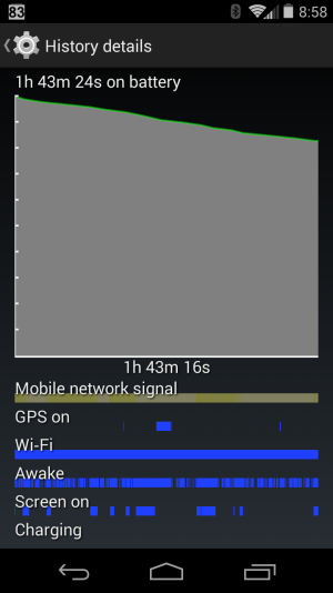

Look at the awake time in this one:
After less than 2 hours of up time I have used 17% battery???

596 mb sent is not normal. Exchange is definitely out of control there. As I don't use exchange mail on my phone, it's hard for me to recommend anything. Hopefully someone else can be more insightful. But that is not normal.

sorry i initially read that as 12.68MB and 596KB (not MB) for a total of only 14MB. so i agree that something is wrong.
OP - what is the sync old email days set at? 30 days?

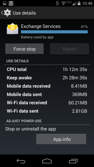

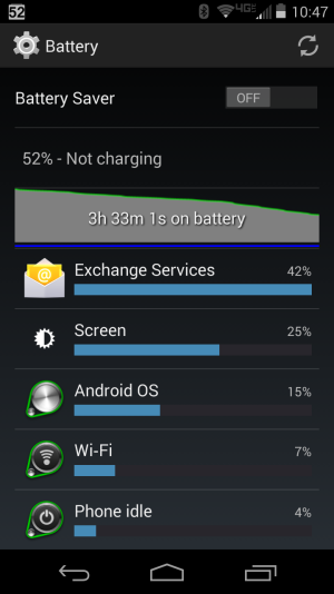

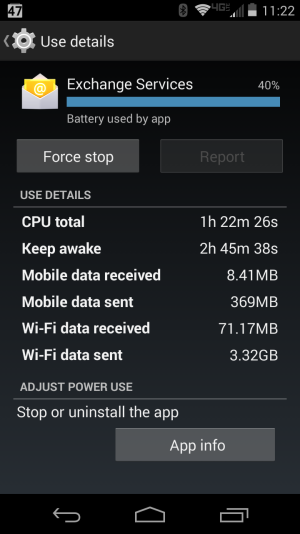

Doesn't appear changing to 30 days helped.
Here's the before and after (34 minutes later)
At this point I am going to remove my exhange account and re-add it, as I am going out tonight and I need my phone and obvioulsy need to charge it. I did this a few days ago, but apparently that is not the fix.
Still looking for ideas...
