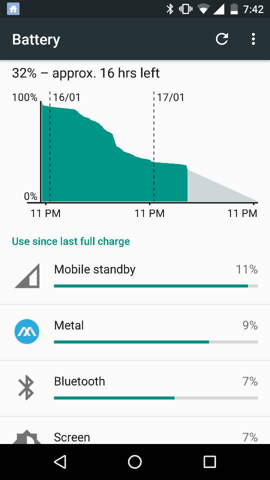

Wifi is at the top of the battery drainage and the report of the battery usage also shows wifi on all the time even when it was off plus there is real battery drainage

Already did that and rebooted also . wifi is gone from that list but when you check the battery reports it shows wifi was on when it was not sometimes

I did everything suggested above, updated to 6.0.1 and I still have battery drain from wifi. It seems that I'm using much more battery than I should be with apps like WhatsApp and Messenger. My battery was full when I woke up, wifi turned off, light usage on 4g (1h18 sot) and my wifi bar is solid, now I have only 65% left. This issue will drive me crazy soon :(
