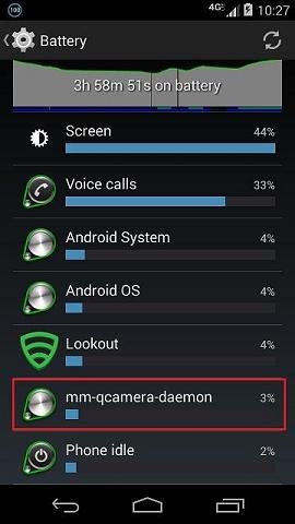

I just activated my Moto X today and immediately updated to Kit Kat. I made calls, reinstalled apps, and took a few pictures to test out the camera. Out of curiosity, I checked out the battery statistics and I noticed a running process (app?) called mm-qcamera-daemon. It wasn't using a tremendous amount of the battery, but it seems suspicious. I did an online search and it looks like it's been an issue (namely battery drain) on other devices as well, but no solution to be found. Has anyone else noticed this on their X? Any information as to what it is or what it's attributed to? :confused:

That would certainly make sense (and it does contain the word camera!). I did take quite a few pictures in rapid succession and experienced maybe a 10% battery drop at most, but I'm not exactly sure because I wasn't monitoring my usage at that point. It's not really an issue as of now, I was just curious to know if it's common and/or harmless.:)
Here's a screen grab (this is where it currently stands, but the percentage was higher early this evening closer to when I was using the camera):

Ok, looking at that, I think Lookout is probably triggering the process. Check out their permissions list. https://www.lookout.com/permissions
Honestly, it's an app you probably don't need at all unless you download random apps from questionable sources. I would freeze or uninstall Lookout and see if that changes things.

I actually installed Lookout after I noticed the mm-qcamera-daemon, but you make a good point about it being unnecessary. Thank you!
