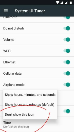

If your phone updated to Nougat already you can remove the time from the status bar quite easily. Try this.
- Enable the System UI Tuner. Expand the notification shade and long press the settings /cog icon until it starts spinning and a wrench shows up close to it.
- Go to settings -scroll all the way down - System UI Tuner - Status bar - Time - 'Don't show this icon'.
