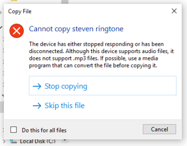

So when trying to transfer MP3 files (drag/drop, copy/paste) into the any section of the SD card (Android folder, Lost.Dir, root folder) I get the following:
SD card is formatted and mounted and the "Transfer Media" selection is on the phone. Any ideas on how to fix this? I used Air Droid which worked but it appears to have put it on the phone itself.

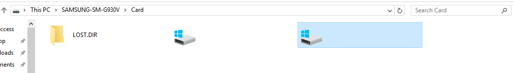

I'm also getting this error when I look at the SD card sometimes:

OK, I just tried a brand new micro SD card (64 gb) straight out of the package (formatted and mounted) and am still unable to transfer files. I tried copying over some folders and it stated it could not copy them. I also tried some pictures off my computer from my camera and the same thing happened. This seems to be a phone issue, not a PC or card issue. Are there any drivers I should download? I have the latest Samsung drivers installed. Should I install Google drivers?

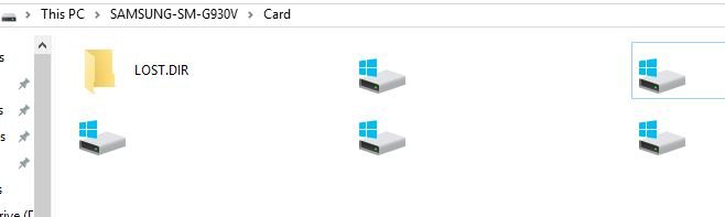

I plugged the phone via USB back into the original computer that was giving me issues. This is what I see now (only one folder actually appears...the rest are unable to be accessed):
So is this a PC issue? Both are running Windows 10. The one that recognized the phone is a newer, very cheap laptop. The one that doesn't is a custom built desktop.

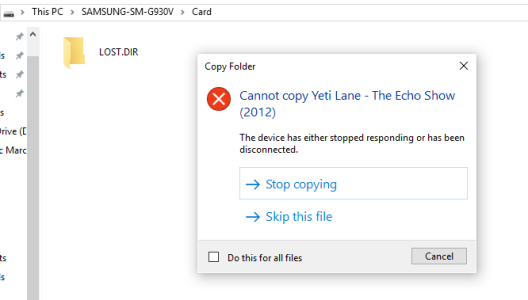

UPDATE: Got the computer and files to recognize, transferred some folders....it got through about 3 songs and then crashed on me and stated it could not continue to copy the files.
