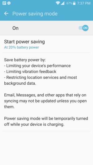

If anyone is still having this issue, You can still stream music while in power saving mode. You just have to make sure that you turn off All background data in the power saving mode. Works after i did this for me.

The fix that allows you stream your music and to keep Power Saving Mode On is to touch and hold the Power Saving Mode toggle on the Quick Access Pull Down menu at the top of the screen. When the options open for Power Saving Mode, turn on power saving mode and then click on the Start power saving words. The default is set to Immediately but change it to what ever setting you feel fits you best like "At 20% battery power". Exit out of that and Viola!! Your now able to listen to your streaming music again while your phone screen is off and locked! Hope that helps, enjoy...

You just need to turn off "Restrict all background data" in Power saving mode settings.
It works for me and I can still stream music while in power saving mode.
