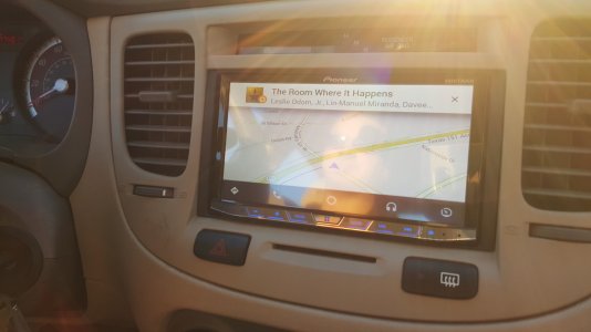

I purchased and had the Pioneer 4100NEX head unit installed in my car two weeks ago, and I’ve used Android Auto every day on the way to work for music playing.
If you buy a new car with an Android Auto compatible head unit, or have a third party unit installed, the setup process is fairly easy: dig into the settings on your head unit to pair your phone over Bluetooth, install the Android Auto app from the Play Store, and plug your phone into the USB port. You do get some extras if you get a new car with an Auto compatible head unit, such as using the car’s more powerful GPS for navigation and a hardware voice action button.
The display will only show a few apps: music, the phone dialer and maps. There’s a voice actions button for voice actions, but more on that later. I purchased the Pioneer 4100NEX, and it has physical volume, mute, home, mode, back, forward, and exit button. While running Android Auto, the home, mode, and exit buttons will take you back to Pioneer’s interface. While I’ve gotten used to the volume buttons placement well enough to change it without taking my eyes off the road, I would still have preferred a volume knob.

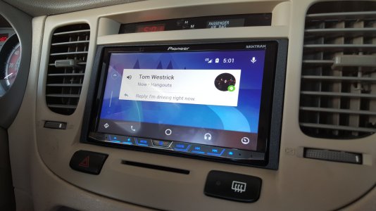

If you receive a notification for one of the approved services, a card will display on the top of the screen, and tapping it will read the notification aloud to you. Once it’s done being read, you can tap the voice action button to speak your reply. There’s also a popup option to tell the recipient you’re driving. You can also initiate a conversation by saying, “Send a Hangout to Sharon Westrick and say ‘Hello.’” Selecting music is just as easy; you can say “Listen to The River and the Thread by Rosanne Cash” as an example for an album, or just saying an artist's name will start playing their tracks.

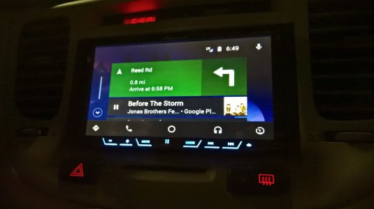

One feature I both love and hate is the automatic brightness and theming: if you don’t have your lights turned on, the screen is very bright and the entire interface has a white background. If your headlights are engaged, the brightness is turned way down and the interface has darker backgrounds. This is awesome when it’s night time, but makes the system very hard to use if you have your lights on because it’s raining or overcast. In the future, I hope there is an option to quickly disable the dark interface after engaging the headlights.

Nice review. I would note that some of the issues you're having, like the screen changing to night mode when your lights are on, are not true in my Hyundai. It seems to operate based on the ambient light, not whether the car lights are on. I haven't had any issues with the volume suddenly increasing, either.
Maybe the headlight issue is another drawback of getting a third party install over having it built into the factory unit. My interface absolutely won't change at dark if I don't have my headlights on.
