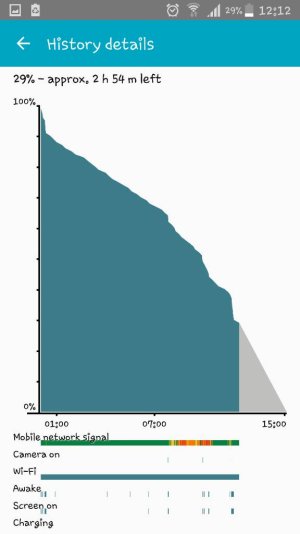

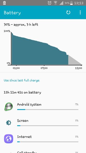

Welcome to Android Central! In these situations, it can be helpful to actually see the stats. Charge up to 100%, then let it drain to 20-30% with normal usage, without charging in between. Then show us:
1. The main Settings>Battery screen.
2. The fullscreen battery graph screen (which shows Awake time and Cell Signal Strength).
3. The Screen category (to see total Screen On time).
4. The Cell Standby category, if present (to see Time Without Signal).
http://forums.androidcentral.com/am...ide-how-post-screenshots-android-central.html
I think you'll need to use GSam to show us the Cell Signal Strength.
I ran into a few problems but got the screenshots up and GSAM wasn't needed... I don't see anything unusual in the battery usage apart from the fact it is a short battery (Remember i said this is a used phone)
It is during use because you got a game, camera and GPS all being used at once.. It don't show on them charts though as a battery drain
I don't see anything unusual either in those screenshots. It'd be hard for me to believe that Pokemon Go is causing the drain, since the phone is hardly ever awake. My guess is that the battery is aging and can't hold much of a charge any more. This will always happen to batteries after enough time, but can be hastened if the user frequently drains it to 0% or near-0%. I'd say get a new battery--or see if you can borrow someone else's battery for one charge cycle, to see if the battery life is significantly better.
