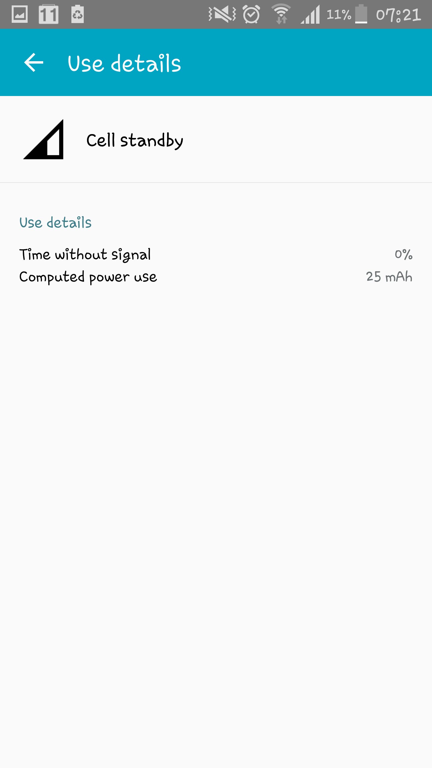

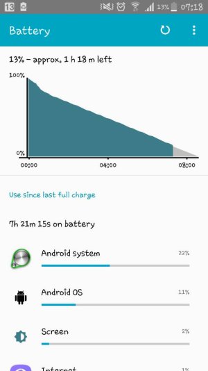

OK update, the battery drainer in my phone is "Android system"... What do I do here?
I looked into the Anker batteries too, like I said, I think it's something in the software that I'm missing
It'd be helpful to see those same screenshots that were requested earlier in this thread, as a comparison. Was the screen on for a long time while you were waiting for the battery to drain, or was it asleep for most of the time? What percentage of battery is Android System using? System is always going to use a decent amount of battery, but if it's upwards of 80-90%, then something is clearly not working right.
The android system has reached 50% before, and I don't know why the phone stayed awake last night? Drained it from 80% to 17% overnight
You need to post the "entire" first screen. All the stuff below is cut out... unless there's nothing else there. Scroll down and post all the apps being reported by battery usage, no matter how low the usage is. Just because an app reports very little usage doesn't mean it's not draining the battery through Android System/OS.
