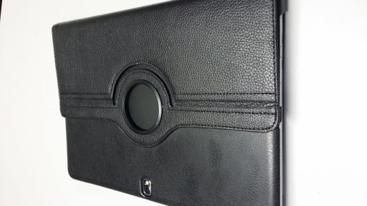

I have this generic case that the flip isn't suppose to be magnetic...when I close it (flip on the screen side) nothing happens (no turning on or off as the samsung book cover case) however when I open the flip backwards it turns off my p905m, and when I, until the flip is full opened backwards, separate the flip from the back of tablet it turns on (just like the book cover does when it closes on the screen, but with my case in the back...). it's weird, but true.
That's my generic case...

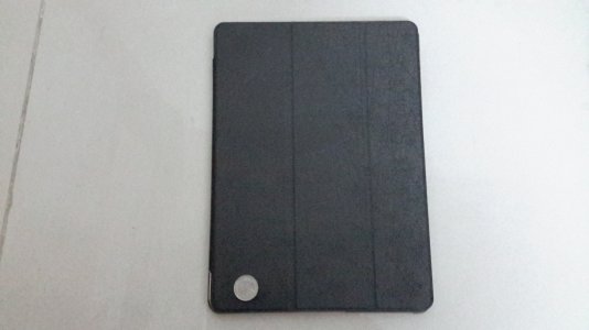

Thank you so much for your post. I found the magnet on the front of the cover by using a paperclip and then I glued a coin over it. This coin is magnetic, it doesn't work if the coin is not magnetic. Your post was very useful.samsung tab.jpg Problem fixed.

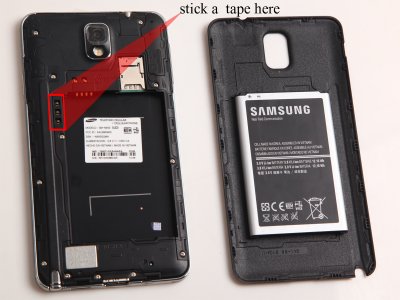

just close the sensors by sticking a tape on.back side of flip cover there r 2 or 3 sensors
