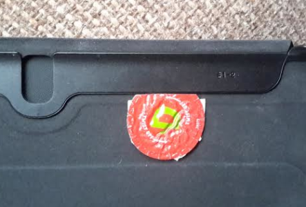

Just to update, and FYI -
I completely solved the issue with the Book Cover. It may be rough, but it works just fine, and cost nothing. Took 5 mins.
If you take the cover off and look inside the back you can see that there is a circular insert behind where the sensor is (presumably to prevent the front cover from tripping it when flipped over the back). This is clearly not quite sufficient to account for the strength of the magnet in the front cover, which as I said comprises the ENTIRE face of both the top section and bottom strip of the front cover.
I assume that this insert is either magnetic, or something ferrous. So just to test my theory all I did was flatten out a beer bottle cap with a hammer and tape it over this insert on the inside of the back cover, so as to increase the degree of interference in that section of the back when the front is flipped over.
It worked immediately. I also cut a bit off the flattened lid so as the fit it to the correct position, and it appears to be thin enough not to even contact the tablet due to a slight step down in that section of the panel.
I did this just to test the theory, but what the hell.. I'm just going to leave it there! After all, you don't see it..
I thought I would share this just in case anyone else had this issue and wanted an easy and free hack, and spare the cost of a new alternative cover :-)
(by the way: the only setting my Note Pro has for the Book Cover is for Automatic Unlock on or off, which merely bypasses the swipe and therefore does not relate to the problem we are discussing - which is that the Samsung Book Cover randomly puts tablets to sleep during normal use)
They clearly need to beef up this insert a bit! Perhaps a bit more product testing required here..?
