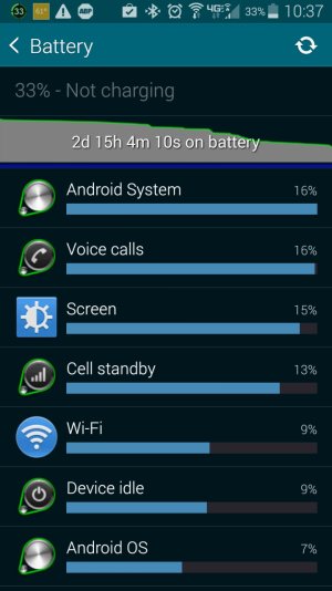

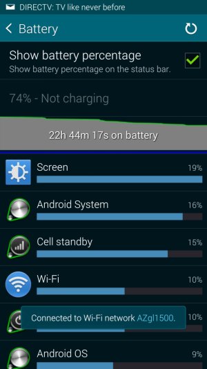

I can make your life a lot simpler with one word: MacroDroid
with MacroDroid you can create macros that will sense the status of the screen.
Screen Locked: turn off the internet (WiFi, Data)
Screen Unlocked: turn on the internet.
I do not do anything else and I get battery life that is great.
If the phone is unused and idle for 24 hours, the battery use is about 8%.
If the phone is used normally, it is about 25% per day.
screenshots.

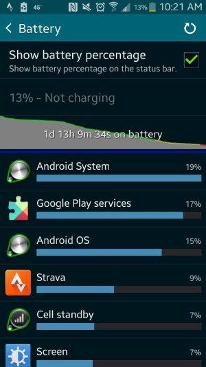

Stock att rom. Battery life is great.
Posting up battery stats without showing your screentime is pointless imo like the post above, screen only on for 7% i.e hardly on at all.
I can get over 7+ days battery life if i leave it in UPSM without using the screen, so, so what lol. Pretty pointless having a smartphone if you're not going to use the screen alot, might as well just get a nokia 3210 if you just need to make texts and calls :)
