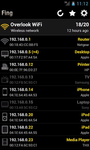

This is just a shot in the dark, but the only reason I can see a device crashing/locking up a router is a IP conflict. If possible, go into your router setup (usually 192.168.1.1 in your browser address bar) and look for "DHCP Reservations" in the DHCP Server section (Usually on the first "Setup" page). Find your Nexus 7 MAC address (Settings> WI-FI> 3 dots (Top right comer under clock)> Advanced>). Reserve it a spot up away from all the others, say 192.168.1.200 (range 1-254, keeping in mind that 1 is the router it's self).
You can also find your MAC address and see where everything on the routers at ( and any conflicts) with this free app called Fing. The MAC addresses being the weird smaller number under all the 192.168 stuff (and yes the colons ":" are part of the number you would enter).

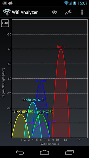

I also like this app called Wifi Analyzer that shows you all the signals out there...
also free...
