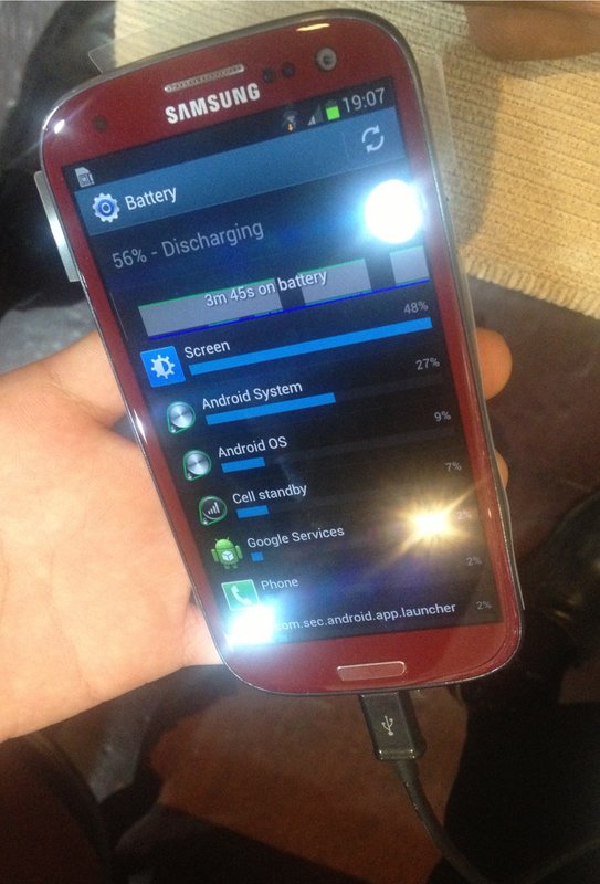

Exact same problem, TWICE!
I bought an S3 two days ago. It could not recharge and I gave it back to the store and got a replacement.
I made sure the phone was able to charge at the store.
Just tonight, I charged the phone before sleeping and made sure it reached 100%.
When I woke up, the phone was dead! I tried to charge it again and the battery was empty!
And like everyone experienced here (and I, last night) the phone won't charge!
It seems this is an international device issue. I am in Indonesia.

This was my 3rd phone in 3 days:
Yesterday, 5 minutes out of the box, in the store, it could not be charged. It seems that after plugging in the charger, it charges for 10 seconds, then discharges. They admitted that I was the 2nd person to recently complain about the red S3. So I told the store that I could either come every other day or they could give me a different color (they earlier said it was a hassle for the stock report if I changed product). They decided to allow to replace it with a different color. I chose gray. No problems with it as of yet. Fingers crossed.
