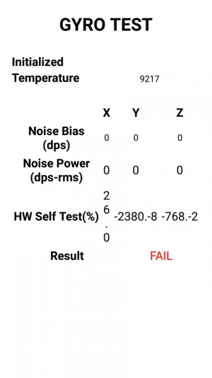

Alas, my gyroscope issue isn't simply the screen rotation setting being switched off --it's apparently a spontaneous hardware failure. I tested via the phone code *#0*# diagnostic and got the attached failures. Otherwise the phone works fine. I went through the whole "safe mode" and factory resets exercise to no avail.
For those wanting to get it fixed, the only way I've found is to set up a return through Samsung. They quoted $70.31 for the initial shipment and work, but indicated that may not be the final repair cost. So I didn't bother. They also partner with a company called "UBreakIFix," but their reps tell me all they do is recommend sending it directly to Samsung for motherboard issues.

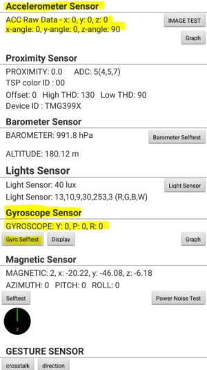

I was having this issue on my Galaxy S5 as well. You can dial *#0*# into the dialer app to open a sensor and display diagnostics app. One of the buttons, Sensor, will show you the Accelerometer sensor readings. The coordinates under the Accelerometer sensor section were unresponsive. I went in and did like Ivan and disabled the Flipboard app, then went back to the *#0*# app in the dialer. For a bit, the coordinates became responsive again, steps were being counted by S Health, but checking a few minutes later, it's having issues again.
On second look, the menu that shows after pressing the Sensor button has another button, Gyro Selftest, and pressing that shows Result Fail.
