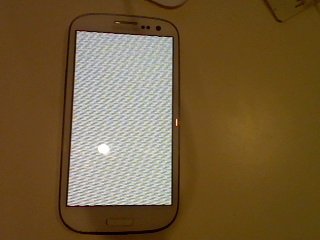

Re: My Samsung galaxy S3 won't turn on
I've done as people have said in this thread before, and this is the result when i try to enter recovery mode. Is there anything else i can do, or is it completely knackered?
Thanks
Tom
Knackered sounds like an appropriate description.
What happens if you try to boot into Download mode?
What led to this mess?
Sent from my rooted, debloated, deodexed Sinclair ZX-80 running CM 10.2 using Tapatalk 4
