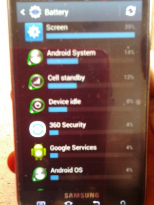

Though the battery is new but drains within 12-15 hours when mostly on idle.
I checked the battery useage after about 12 hours and realised, the Screen which was on for 49 minutes used 40%, followed by Cell Standby on for about 11 hours used 14%, and phone idle for over 12 hours used 10%.
Please, how can I solve this problem?
If, after that, there was little charge remaining, the battery may be bad....or possibly the device if you had similar trouble with the preceding battery.
Is your signal good? A poor signal will tax the battery.
I always charge it to full. I think the signal is okay, besides if that is not the case will it not be the Android OS consuming the battery rather than the screen?
As I said earlier it is mostly idle but find the battery useage like:
Screen - 40%
Standby- 14%
Android Os- 10%
Device idle - 8%

The stats look normal, and you are right....evidence of poor signal would show somewhere in the stats.
A poor-quality battery, perhaps?
Thank you. For the battery, I think it is not bad but I might agree with the signal. So, is the stats look normal even though it is mostly idle? What can I do to solve it?

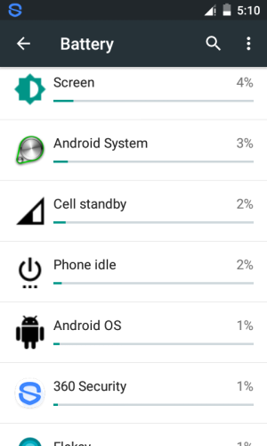

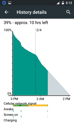

Thanks alot. I installed Paranoid Lollipop 5.1.1 in my phone and the battery drain reduced insignificantly. After 8 hours idle, 40% of battery was consumed, so when i checked the battery stats this is what I saw. so I am tempted to believe it is signal problem. If you add the percentages, it is not up to 100% but 18%. Below is the picture of the battery stat;
View attachment 215466View attachment 215467

Yea it might be your signal as i see its yellow.
I see you use 360 security... but what for? It has lots of bad tools that harm your android device which can also cause heat.
Posted with ❤Love❤
