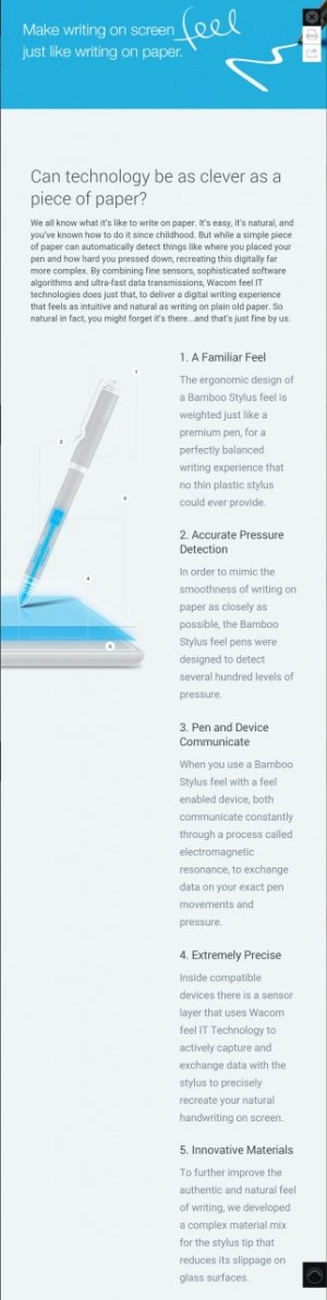

Here you guys go, caught via scroll capture. ^_^
Sent from my SM-N920T using Tapatalk
