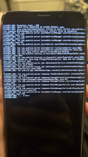

It worked, kind of. Odin did its job, and reported success, but it errored out again. I managed to take a photo with a friend's phone of the recovery log and throw it into a image to text app, and got this:

Any ideas on where to go from here?
