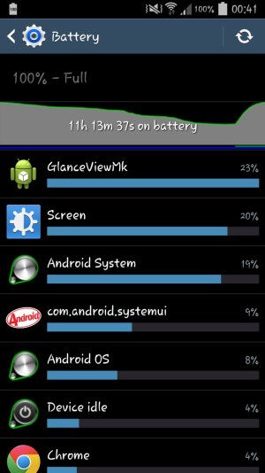

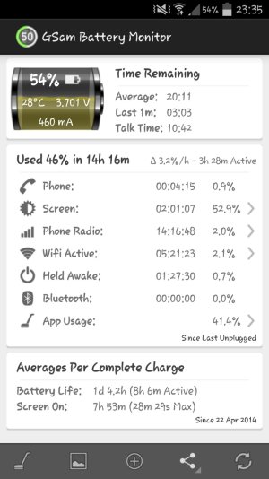

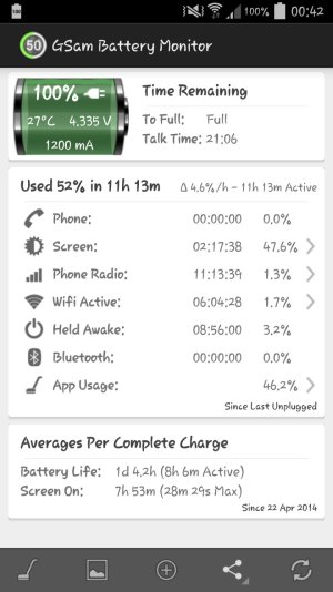

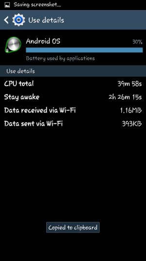

Hello, I am new here and registered because of the current problem I'm having as its driving me insane.
2 Days ago I received the update to KitKat 4.4.2 on my S4 (Carrier 3 in the UK), and have noticed my battery is being drained much quicker than when on 4.3, I did do a factory reset after installing kitkat, I dont really want to do another one if necessary.

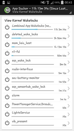

So today I decided to monitor the battery usage using the Gsam Battery Monitor app and discovered that in a total of 11 hours usage the phone was kept awake for 9 of those hours, as in not being able to go into a deep sleep...this resulted in 52% of the battery used in that time..and while that doesn't seem much..I only used the phone to send about 10 text messages and about 15 minutes of web browsing. (in comparison my GFs S5 used about 20% total battery in the same amount of time with moderate-heavy use).
Unfortunately due to the permissions of KitKat I cant see exactly what was causing the phone to stay almost constantly active, however upon checking the wakelocks on Gsam it showed "Combined app WakeLocks, non-kernal" was awake for 11h3m in an 11h13m total use time, but I have no idea what combined wakelocks are :(.

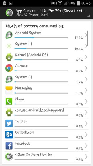

Looking in the app usage section of Gsam showed the usual "Android System" at the top 17.4%..followed by System 10.2% (which has a GPS icon and when opened shows a service relating to my S-View cover?) then Kernal Android OS 6.9%..now while this doesn't explain much, I decided to check the built in battery monitor and it showed that the biggest use of battery was a process called GlanceViewMK at 23%, (above the screen at 21%), and when clicked on..shows 10hr53m stay awake with 43m of CPU usage.
Surely this isn't right? for a process which I presume, is the one activated when you wave your hand over the sensor to show "information preview", would this really keep the phone awake for almost 11 hours?.
Now as I have only just noticed this about 45 minutes ago I haven't managed a test with the "info preview" setting turned off in the phone settings, but I just wanted to post my findings/information in case it was useful to any others with problems relating to this and the constant wave of bugs that seem to plague the 4.4.2 update.
Or if I am completely wrong and someone with a lot more knowledge on the matter (im fairly a noob when it comes to mobile OS's) can shed some light or even just a thought of how to solve this problem.
I will disable the option and report back after a day of use tomorrow with my findings..I will attach some screenshots to help explain, if I haven't explained clearly enough :)
Any help/advice is greatly appreciated :)

I agree with Golfdriver. If that doesn't do it, and GlanceViewMK is still keeping the phone awake, force stop it
Sent from my Galaxy S4 running SlimKat 4.4.2

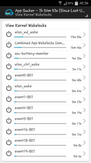

Glance view I believe is for quick glance. Try disabling it in settings to see if it helps.
In gsam can you post the screens "view number of times waking device" and "view time held awake"?
dpham00, Android Central Moderator
Sent from my Verizon Samsung Galaxy Note 3

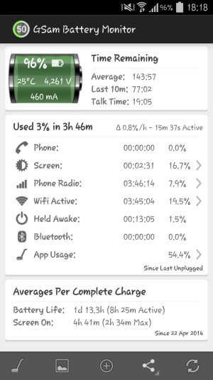

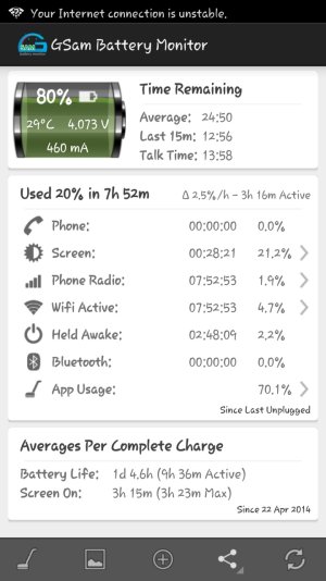

Thank you guys for your replies.
I havent tried the recovery and clear cache method as after disabling the quick glance in settings last night, seems to have stopped the drain and the GlanceViewMK keeping the phone awake...to a point, as in, its back to similar results experienced on 4.3.
Currently in 14.5hrs usage the phone has only been held awake for 1hr27mins. Which is a huge improvement over yesterdays 11hrs and 9hr awake.
I presume this is a new bug in the 4.4.2 software with glance view as I haven't seen any other posts with similar problems, presumably just my luck to get it. Im happy to leave it switched off for now though as I hardly use it..however it is strange that I could leave it switched on in 4.3 and experience no problems at all.
Luckily that is the only problem I have had with the KitKat update, as I have seen many listed, I do still however, as a number of people i've seen on forums and the internet, have my Android System process at the top of my battery usage stats (higher than the screen), seems this is a kitkat wide problem with a number of devices and no specific fix?
I will attach some new screenshots of today's testing, unfortunately dpham00 I cannot attach screenshots of "view number of times waking device" and "view time held awake", as I am not rooted to access those features on 4.4.2..which is something I miss from 4.3 as I could of identified the problem much easier.

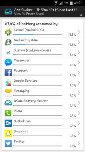

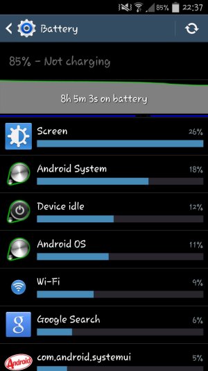

Excellent, I'm glad you found the culprit that kept your S4 up, as I was afraid when you mentioned S View Cover that it was a hardware fault that I once experienced which kept the phone up and flashing the S View Cover UI frequently, that required a visit to Samsung Smart Care.
Okay, so Android System, yep, seems to be a major Android KitKat problem, the best way I've been able to keep it down is turn Off Location altogether, as I type this, Android System sitting well below Screen:

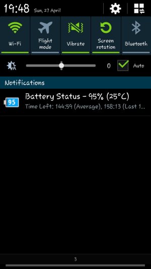

The sview thing is still there in gsam battery but i honestly don't think its causing much of a problem as today, granted I haven't used my phone THAT much, but even for idle my stats today are pretty good, with around 8hrs5mins of on battery time, I still have 85% battery remaining, with the screen sitting at the top of the battery list once again..doing the occasional text, facebook, photo upload to dropbox, low signal areas, wifi on etc...
I went through all settings last night, turned off some Google syncing (ones I dont need), in the samsung apps i disabled auto updating, push notifications and check for updates, disabled some apps which I thought were hogging usage,, disabled google voice recognition for "Ok google" as i never use it and completely disabled the Samsung account sync as I really dont use it at all..
So now I am fairly impressed with the battery life I am getting as at one point using Gsam..reported I had around 212hrs of use remaining..This shocked me..however before I could get a screenshot it went down to around 158 hours.
Will post some screenshots below

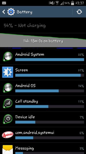

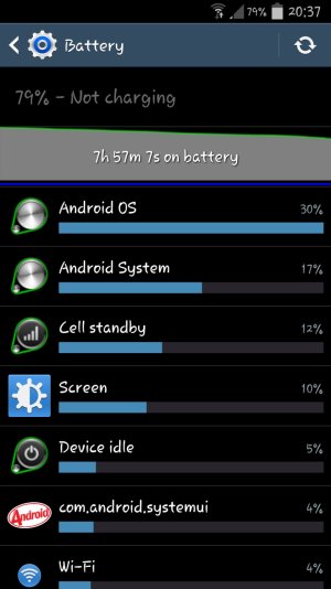

So after a good 2 months here I am again with more problems relating to battery life. I havent changed a single setting on my phone since I sorted it earlier on in this post back in April, in fact I've probably turned more things off, yet once again during the last few days I have experienced fairly crappy battery life..at least compared to what I was getting.
My phone is largely once again staying awake, and even if it is not, my battery is still being drained more rapidly than usual and I am at a complete loss as to what it is this time..Unless of course i'm being irrational and this is completely normal but I would of thought that 20% loss of battery with only 29mins of on screen time is fairly bad? compared to when I Could go 14 hours or more and only use roughly another 20% of battery..But i know that it is being drained a lot quicker than usual..
With WIFI on i know there are problems with that but if i take wifi off then i get the fast dormancy wake lock, that keeps my phone awake for just as long..im starting to think Android is just plagued with bugs and wishing the 4.4.3 update would hurry the f**k up..
Here are some screenshots...whether this is normal or not I dont know, but compared to my normal stats..it isnt
