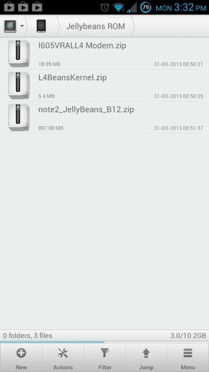

I'm having some trouble with this new rom , is only displaying 3g connection no 4g for some reason. I have jelly beans build 12, jellybeans kernel and the I605VRALL4 modem. I dint even know what the modern is abs I don't know if it is the latest. What about next time I want to flash another rom ?
Sent from my SCH-I605 using Android Central Forums
