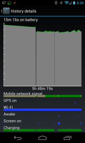

I got my N4 in the first batch. Except for a cosmetic defect (off-center camera LED) everything seemed fine. A few weeks ago I started having the charging issues reported by others in this thread. I attached a screenshot of what this looks like. In addition to the obvious failure to charge fully I also noticed a more subtle error, which is that during discharge the battery level will get stuck at a certain value for prolonged periods of time (despite heavy use), then precipitously drop to a lower value. So I think this may be a hardware defect in the voltmeter that measure the voltage of the current (which decreases as a battery discharges).
Honestly, I think you are getting what you pay for with this phone. They probably used the cheapest possible components (except those that show up on the spec sheet) and rounded things off with really bad QC. I have no backup phone so I can't even RMA this one for the time being. I am worried that one day it will stop charging altogether.
Ive had the same problem with my n4. I have 3 chargers. The stock one. A samsung galaxy s blaze 4g charger and a car charger. All three use to work flawlessly when i would charge my phone but recently my phone wont charge in the car anymore and sometimes not even with the samsung one although all three are micro usb. Isnt this the point of a universal charging system? It seems to always work with the stock charger. But its odd thatwhen i first got the phone it would charge with all the wires especially the car charger which is important but now it does not and i have tried using different micro usb car chargers.
I don't believe this has anything to do with the charger per se. If the chip that controls the charging of the battery is defective then it might behave differently depending on the current. The current each charging method provides is different. USB is 0.5 A as far as I know, while a regular charger is 1 A. The charger that comes with the phone is 1.2 A. A non-defective device should be fully charged by any of these, albeit at different speeds.
What seems to help is a cold boot (i.e., take it off AC power, then shut down, then turn it back on after a while). It's not a cure as the problem reappears after a while in my experience. At least today this allowed me to fully charge my phone.
Same with me. Left it charging overnight... when I woke the phone was hot (although my missus's nexus4 was cold) hers was 100% and mine was stuck at 60%. Turned it on and off and it started charging again.
Had another problem today. It was down to about 14%, I put it in my car charger and in about 20mins it said full! Later that evening it died while I was using it at about 80% !
