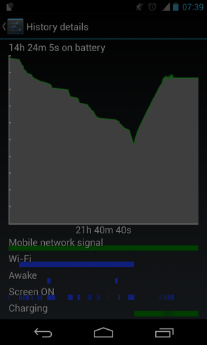

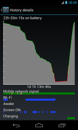

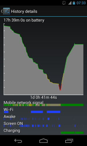

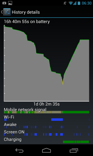

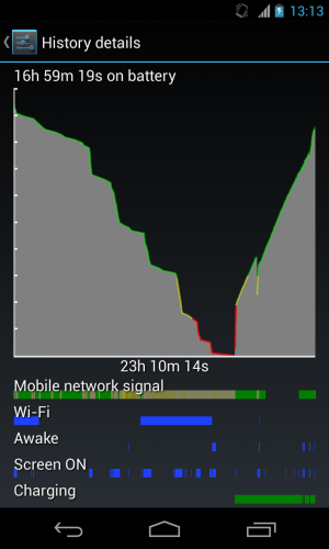

I'm getting some erratic battery behavior also. One where the battery just stops charging and evens out at a certain level (different each time) you can see from the screenshots it still says its charging but the battery doesn't go up.
I've had the phone since launch and the battery has charged normal most of the time (I'm using the supplied wall charger) but this has happened about 6 or 7 times now.
It also seems to charge really slow some days (6 hours +) Also, one of the days it never fully charged my phone died on me so tried to charge it while turned off and it has not charged at all even though the on screen indicator is saying its charging. I have tried a couple of times to charge it while turned off and it hasn't worked so not sure what going on
