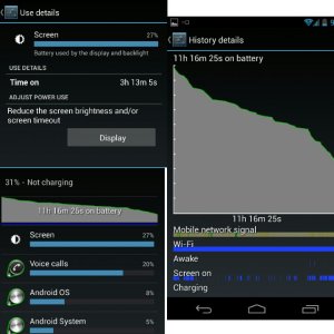

It's definitely you. Mine lasted 14hrs with very heavy use today. I took this at 11hrs though.

Note the huge difference in this guy's stats in regards to battery consumption by the screen (27% vs 42% for the OP). Also, note the conspicuous absence of Chrome from the top of the list (another 11% for the OP). Take it from me, web browsing consumes far more power than does voice calls; partly due (I expect) to differences in the power consumption of the radios used for voice vs. data, and also because web browsing by definition includes lots of screen time as compared to voice calls where the screen typically turns itself off for most of the duration (unless using speakerphone).
Also, while on this subject, the OP should make sure that the his N4 is set to go to sleep within a reasonable period of time - preferably no more than 2 minutes. Better yet, get used to using the power button every time you set the phone down. You will be amazed by the effect on battery life from these two simple steps.
You see, that's amazing. That's how i want mine to be. Handcent did get updated for android 4.2 but im not so sure about twicca. But i did factory reset the phone and didnt install ANY apps to see if that would help but nope. still around 9 hours, 2 hr screen time. Im gonna turn off auto brightness and set it to around 20%. See, I knew it could be better.

Another thing, notice how your blue bar under the main battery stats is solid? Mine is all cut up. Should that be a concern?
Because the op had more screen on time in less hours meaning he used his phone more.
