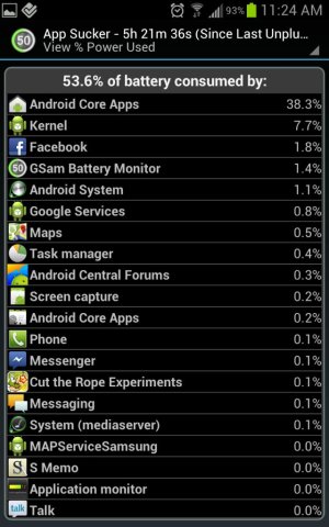

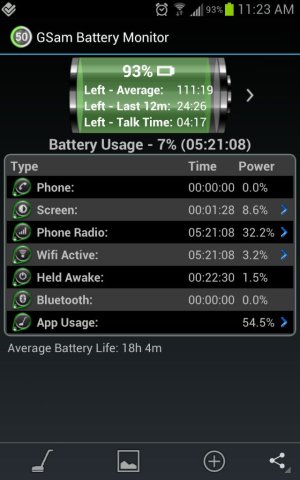

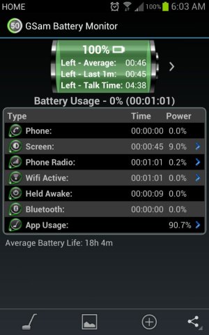

Here's some screen shots of my galaxy note left on over night on wifi. This is with auto sync off but I do have flip board, Gmail, the weather widget and Facebook auto update every hour. This is after about 5.5 hours of sleep. Not sure if u can spot any major differences to see if maybe u guys have an app problem or not.
Sent from my SAMSUNG-SGH-I717 using Android Central Forums

Zilch smart ass. I'm a frequent user of this forum.. Why would I post about it if that was the case? Props from a bunch of dorks across the country? FOH! I'm sharing what happened for me. I hate you Android conspiracy theorists. This phone is not like any other Android phone you or I have had and you're definitely not knowledgeable on it this soon. Go ****** and get off mine if you don't agree sir. Kindly.
Also with the N4 when you recharge while powered on the battery stats will auto reset to zero hours. Genius! *Drops mic*

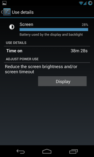

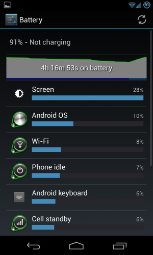

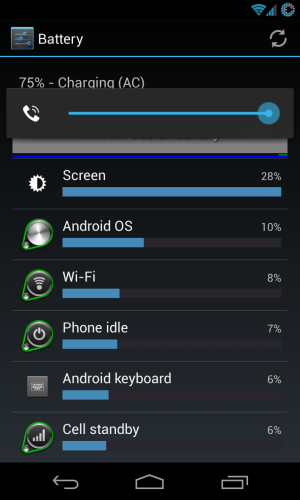

Actually as you can see by the screen shots provided you can in fact charge the phone without resetting the counters. I've owned one of my Nexus 4's since Nov 15th, tried different roms, disabling damn near everything, including setting brightness to zero and the best screen on time I have EVER seen was just past the 4 hour mark. Additionally there is nothing so drastically new in this phone that it renders experiences with other devices irrelevant as you suggest, and I'm confident in saying that in general 8+ hours of screen on time is pretty remarkable for most smart phones and closing in on utter BS when talking about the Nexus 4.

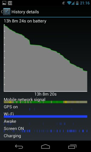

See this screenshot :
I don't know how much battery effect this has but since reflashing and turning this off the battery has been noticeably better.
What "report from this device" does Peejay is enables apps to report your location. Disabling this does disable things like Google Latitude, but it limits apps ability to constantly use your GPS throughout the day to locate you, which is why Maps usually has a higher battery drain than other apps.
But yeah 70% after 13 hours isn't too bad, you had 13 hours plus 5 hours more estimated. 18 hours of usage is not bad for a smartphone.

Hey Dirk, I think Ryanr has an excellent point. in your overnight results you have over 6 hours of phone radio usage, but only 2 hours of wifi. I'm assuming you have wifi at your house? So it must be using cell radio when it's slept...
Oh I just read your post, why would you turn wifi off overnight? Wifi is ridiculously more power efficient than the cell radio. Especially in 4.2. Go into Wifi in settings, three dots, then advanced and make sure Wifi optimzation is on. Please do the overnight test again with Wifi on, I suspect you will see night and day differences.
Also, whatever you did right before you took the first overnight screenshot drained the battery like crazy. It had 12 hours left average, but only 2 hours left based on your usage in the last 12 mins.
Lastly, there is definitely something wrong with some of your apps. If anything, before sending it back I would do a factory reset. Your Google services app has 1288 times waking the device over 6 hours, mine has 113 over 11 hours.
And wtf... your clock app took 10% of your battery? Mine is zero percent, there is something definitely wrong there, but you didn't post details on the clock process so I can't guess.

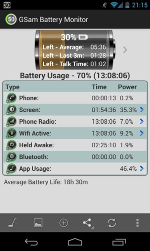

Well I've finally stuck it on charge, I've managed over 4 hours extra life since yesterday and I've really hammered it tonight trying to make it drain, either the reflash or the Map setting I turned off has done the life a world of good. If this is what I get every day then I'm a happy man :
www.pjitsolutions.co.uk/pics/share/batt6.png
www.pjitsolutions.co.uk/pics/share/batt7.png
www.pjitsolutions.co.uk/pics/share/batt8.png
