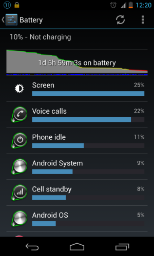

I downloaded a battery app last night. It shows that the biggest consumption by far is the screen. I checked wave lock, and it b is under 3%, so that seems normal. It doesn't show any app as being that hungry. But I will post screenshots soon.
I'm trying to run the n4 on WiFi a lot today and tomorrow to see if that makes a difference. Is it b really the case that if you have a weak mobile Internet signal that could be a reason for major battery drainage?
