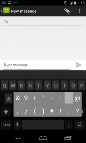

So far and also today there is another issue -- the touchscreen seems like it's not accurately registering my touch location. Typing a message is kinda tough, I have to add some allowance to where my finger should be. This is especially tricky / noticeable when using the long-touch shortcut on the period -- it's impossible to select one of the quick shortcuts, and the menu disappears.
Man, what is happening here?!
