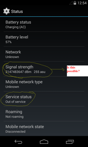

Screenshot_2014-09-12-00-54-35.pngScreenshot_2014-09-01-20-33-42[1].pngScreenshot_2014-09-05-13-48-49[1].pngHi all
i am facing a signal strength issue after replacing the charging port.
Some how the charging port of my Nexus 4 is giving a problem so i went to a store and replace the charging port of phn. After that i am facing drastic signal strength issue. Before replacing the charging port at home my ph shows a signal strength of -70 dbm to -80dbm but after replacing the the port it showing the strength of -87 dbm to -107 dbm. i have observe that if the signal strength goes beyond the -92 dbm i am not able to call anyone or receive the call. Even i cant send the SMS.
Also in my office before replacing the port phone never get disconnected from network. But after replacing the port i am facing the no network in the office.
even i observe at my home it showing the network signal but when i check in setting>about phone> signal strength it shows out of service
i have to switch to airplane mode switch back to normal mode then the network get connected. Some times i have to manually search the network. And one thing i noticed before replacing the port when i am in no signal area i didnt get the exclamation ! mark symbol as shown in above pic but after replacing the part it is appeared when i am not in network.
any one have the solution for the issue i am facing
Welcome to Android Central! I think I've seen at least one other post about this, which leads me to think that some important part of the cell antenna is right near the charging port, and may have been damaged during the replacement. I would discuss this with the shop that did the replacement.
