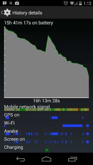

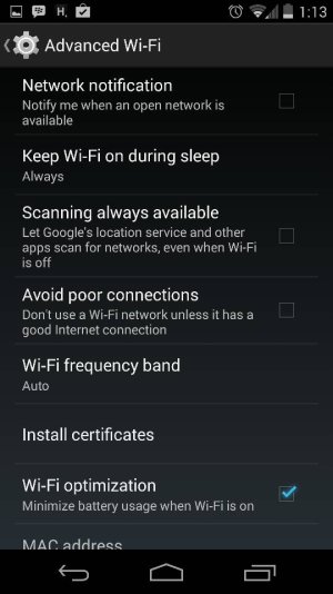

I've been trolling the forums and nobody seems to provide an adequate explanation for the solution to fixing the issue. First off, your phones are not defective. You configured the WiFi settings incorrectly. Second, I'm going to go out on a limb and make a generalization. If you are having battery drain issues, then you will see on the battery detail history screen that your WiFi is constantly on. On my phone once I fixed the issue, my WiFi battery usage displayed periods of on (blue) and off (black). Your battery history details for WiFi will show solid blue across this screen if you're having battery drain issues. To fix the issue disable Google Now and then go to WiFi, advanced, and disable the setting that keeps WiFi on even when you choose to turn WiFi off. For the next hour, check your battery history details field for the color black to see if your WiFi is actually turned (OFF). You will also notice that your phone runs cooler when you touch the back top side near the camera.
