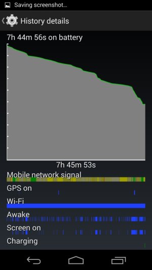

Can you take a screen shot of your battery stats? People may be able to help you figure out what is happening.
Here is mine from yesterday. I had 76% left after about 8 hours yesterday...

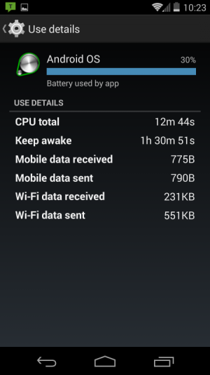

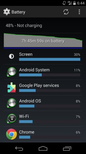

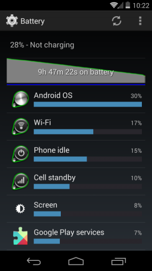

See below:
It's the Facebook app. Google it for more info.
The "refresh interval" is by default set to 1 hour, which doesn't seem to extreme.

First I wanna say awesome forum I've been lurking and learning as much as I can since I got my Nexus 5. I had an issue with my N5 draining very quickly too.
I read every thread in the N5 forum on battery life but couldn't find my answer but it gave me a start. It was something to do with Google's Play/Now service.
You'll notice you'll get better battery life if you switched location from Very Accurate to Battery saving mode. However it didn't give me the battery life I expected and I noticed Google Play Service had a high wakelock time. So it was a combination of the GPS draining and Google Play as the service accessing it.
What you need to turn off is 'Location Reporting' for Google Play/Now Service (It's a total of 3 listed services that give you the Play/Now/Search experience)
The Location Reporting service is not necessary for Maps, Google Now to work properly. Turning it off also allows you to keep "High Accuracy" in location services for Maps and Tomtom etc.
What location reporting does is all allow Google to do crowd sourcing.
It looks like your wifi is on even though there is not a wifi connection.
Go in the Advanced menu of the Wifi settings and uncheck "Scanning always available" even wifi is off.
