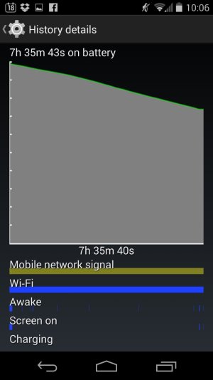

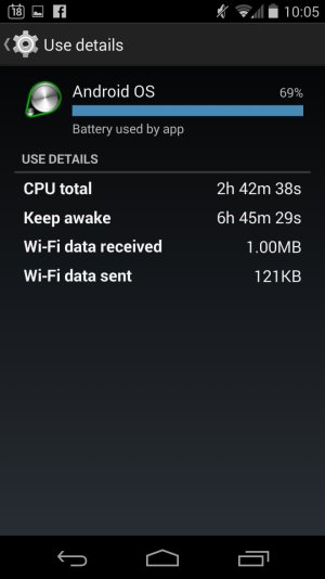

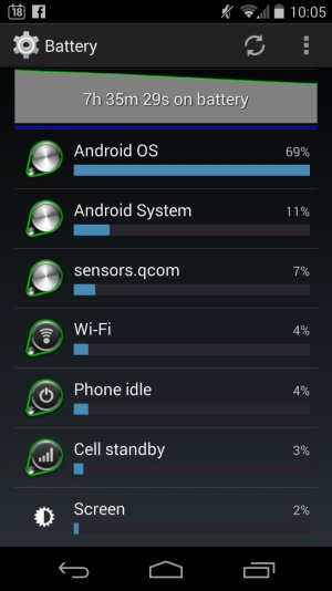

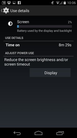

So....since I never got to the bottom of that battery drain issue, I decided to not get the RMA and test the phone as is after I performed the factory reset. Even with the OK Google functionality on, the problem seemed to have gone away. That is, until last night. Once again, my usage patterns have not been changed at all and out of nowhere I'm getting massive battery drain while I'm ******* asleep and not even touching or using my phone in any way. Went to bed with 100% battery, decent LTE and Wi-Fi connection, all apps closed via multitasking tray....woke up 7.5 hours later with only 75% battery left (which you can't tell precisely from my screenshots but is true, my apologies).
So anyways, here are some screenshots of what went on with the battery last night, any feedback would be greatly appreciated:
2014-01-18 18.05.38.jpg 2014-01-18 18.05.45.jpg 2014-01-18 18.06.07.jpg 2014-01-18 18.06.39.jpg
Do you have Facebook or any other social stuff installed?

Yes, I do. Facebook, Facebook Messenger, Instagram, Skype, Snapchat, Tango, and WhatsApp (though the first three in this list are really the only ones I actually use). As I've stated before though, these apps have all been on the phone since day 1, yet the problem only appears intermittently and seems to be more tied to the OS of the phone and/or OK Google hotword detection being turned on (well on the latter, that's the only correlation I could come up with before I did the factory reset).
Look....I get that a phone with Facebook installed is going to drain battery a bit quicker than one that doesn't have it installed but:
a) I've never had a noticeable battery drain from these kind of apps on my other smartphones
b) this is a very powerful, top of the line device and I'd like to use it as such....as opposed to avoiding certain features or apps simply because I'm so paranoid of losing precious battery life. Though having said that, I do take just about every other precaution aimed at conserving power usage (brightness kept low, only sync and download via Wi-Fi, no haptic feedback, no Google Now/Google+ services, location in battery saving mode, etc.)
Not to say I wouldn't be willing to try erasing some of these apps in an attempt to isolate the issue but I really don't think it is necessary or the root of my problem. And of you I'd ask: why would an app like Facebook cause no problems for a week or two and then out of absolutely nowhere decide to just start raping my battery life? Then again, why would any problem whether it be with the OS or a particular app behave in this manner? My iPhone 4 with a three year old battery ran all these apps and more, was on a higher brightness setting, was tweaked with all sorts of jailbreak mods, and pushed information from apps at a more frequent interval....yet still had none of the battery drain issues I am experiencing with this device.
