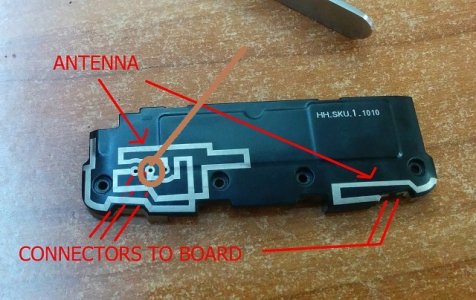

I just fix my problem with Nexus 5 signal GSM lost. this problem made me crazy so I open the back and looks inside and put my finger
on the bottom there where is antena and boozer and in this moment my gsm signal back.
So I took very thin wire (about 10cm) and put it in the middle hole and now I have super strong and sharp signal.
