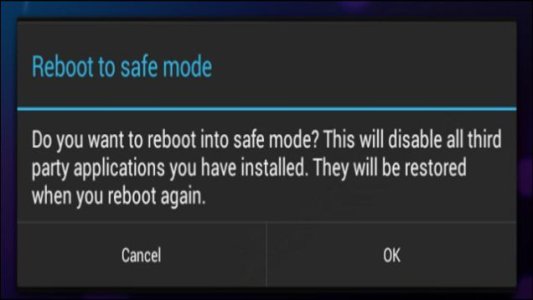

Boot the phone into Safe Mode, then call your phone from another. Does it work correctly? If yes, then you have a misbehaving app. Personally, I would begin by looking at notification managers.
To boot Safe Mode:
1) Turn phone on
2) Press and hold the power button until menu pops up
3) Long press on the Power Off option until this pops up
4) Tap OK.
