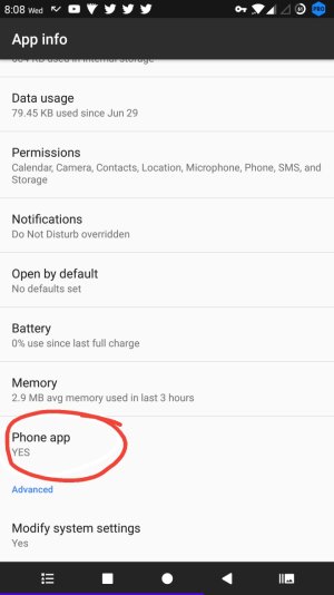

Well, I too had this problem and the thing was that my default phone app was not the one that comes pre-installed in stock Android and once I made it the default one, I got my problem solved...
To change your phone app just go to Settings>apps>Phone>Phone app and select the Phone
OR
Go to Setting>app and then click on the settings icon in the top right and select the primary phone app as default!
