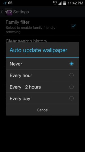

You might have nailed it. I uninstalled Zedge, ran the off/on cycle twice, and did not have any wallpaper changes. Thanks.
If it is, there isn't a way to stop it though. I looked in there settings and nothing to check or uncheck on this type of issue...
Yep......I checked, too. I'll probably leave Zedge uninstalled until they fix the problem.......if that IS the problem. LOL. Thanks.
I use Zedge a lot for stuff so I will just suffer until the problem is fixed lmao.
