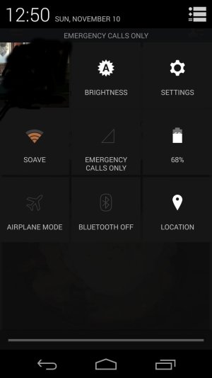

Are you guys getting the orange wi-fi logo like this:
Wow mine has never been orange before..what does that mean? Looks like a Halloween thing :-P
I see that orange WiFi icon quite frequently too.
