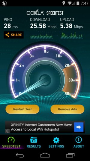

Well, I think nexus is to blame. It can use whatever, but it shouldn't be slower than all other wifi devices in your home ... and it shouldn't be slower when tested with all routers you have at your home (in my case it's 3 routers - westell, dlink615, wd net600)... and it shouldn't be slower when tested with free hot spot (xfinity, not sure what they use and how far it's located, but it was installed recently). I don't have ac routers, but it's slower at g, b, n and whatever free hot spot uses...
