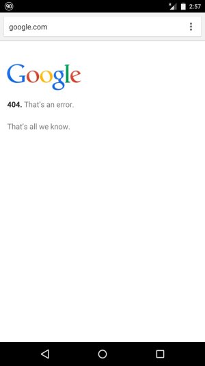

I turned on voLTE again. I can't stand this HSPA crap. I was connected to LTE fine until I tried to send my mother a text message and the phone dropped down to HSPA and then the stupid phone stayed on HSPA with of course unreliable internet. Listing to Slacker Radio after the song finished it poped up network error. Loading Chrome as you see below no connection. Then one minute it works then it goes dead and nothing connects even though it shows a stronger HSPA signal. No amount of airplaine mode toggle can get it back to LTE even though it was only 1 to 2 bars compared to 3 to 4 HSPA. I actually had to go all the way back upstars to get it back to LTE then I set it back to voLTE and made a call downstairs to check it and it stayed on LTE then I streamed something no problems.
When LTE is strong it will connect from that horrible HSPA to LTE right way but when LTE is weaker still more reliable the phone plays dumb and stays on HSPA. I can deal with crackling calls on voLTE as they usually clear up after a few minutes anyway. It is not like I am recording the phone calls to burn on a CD. :D
