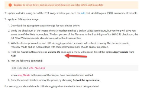

  3. Make sure you downloaded the full OTA file for your specific device from https://developers.google.com/android/ota
  4. Now, if you execute "adb reboot recovery" (without quotes) on the command prompt on your PC, it should reboot your phone and get you to a screen with Android Logo with red exclamation mark - do you get that?
  5. From here, Hold the Power button and press Volume Up once, and a menu will appear. Select the option Apply update from ADB. Done?
  6. On your PC, execute "adb sideload ota_file.zip" (no quotes, replace the zip filename appropriately). What happens when you try this? If there is an error, what is the exact error message?

I did not do "apply update from ADB" step, that is not listed on the developers site.
I directly typed the cmd "adb sideload <ota_file>.zip" on the PC. Which fails saying "no devices found..."
I tried the update again, this time with the additional step of selecting "Apply update from ADB" on the phone before doing "adb sideload shamu.zip" from the command prompt on the PC.
Same problem!
It say "applying update ..." then a few seconds later "No devices of emulators found".
