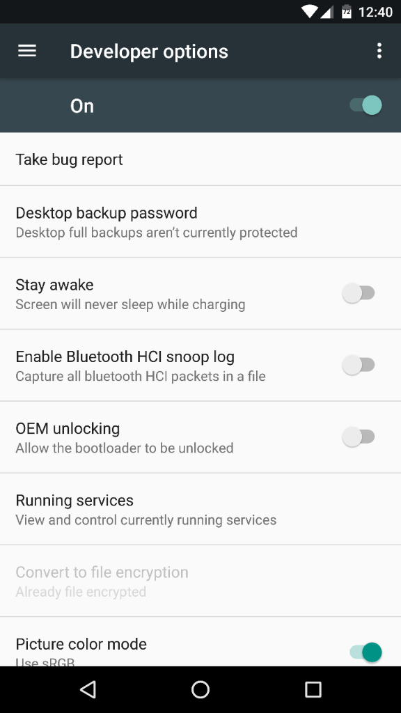

As for logging, you can go to Settings ->Developer options (obviously that has to be enabled if you don't see it) and turn on 'Enable Bluetooth HCI snoop log'
I haven't personally used that feature, so I can't even tell you where to find said log file, what it contains or how difficult it will be to interpret, but perhaps someone on the Google forums or over on XDA can supply that information.
Edit: you'll find 'btsnoop_hci.log' in the top level directory when you open Explore (or whatever file manager you prefer). I don't happen to have an app that will open log files but I'm sure you can find one.
Another Edit: after more digging it's unlikely that you'll get any benefit out of this. I couldn't find an Android app that would make any sense out of the log, and the only program (Wireshark - available on Windows) that I saw identified with it requires some in depth communication skills. Sorry.
