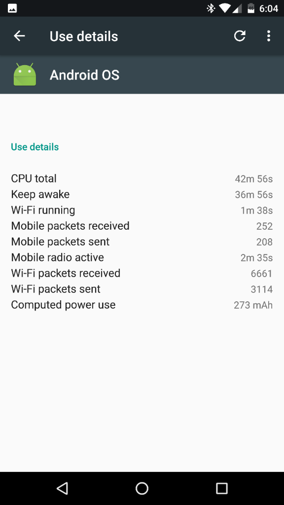

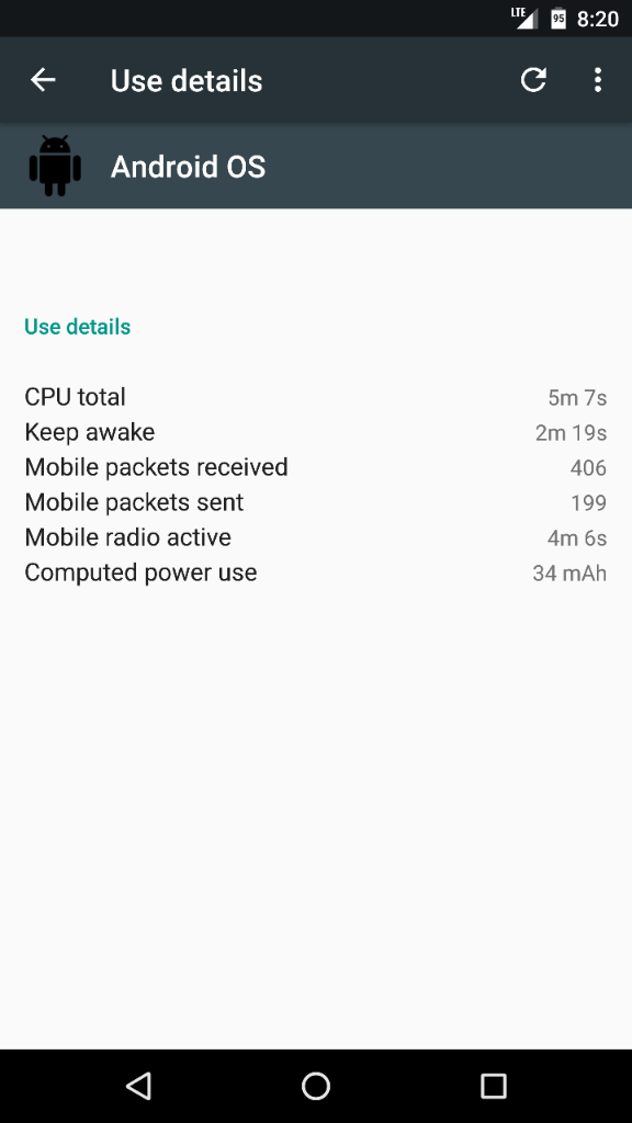

About two hours later, I went from 100->95%, 4% of which was Android OS, and mostly seemed to be "Radio packets", which I would assume is my BT radio.
Where do you see these 'radio packets' listed? In Settings -> Battery -> Android OS all I see are 'Mobile packets sent/received' which clearly seems to be cellular rather than Bluetooth.
Yeah, I'm pretty sure it falls under the WiFi packets, at one point I fiddled around, sent a bunch of BT data, and saw it get counted there. Obviously, without the granularity to differentiate the BT/WiFi packets, it's tough to peg this.
I appreciate your checking, I wonder why you don't see this, and why I do, even with no BT devices connected, it's pretty weird stuff.

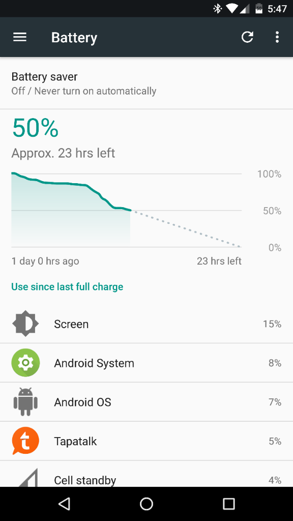

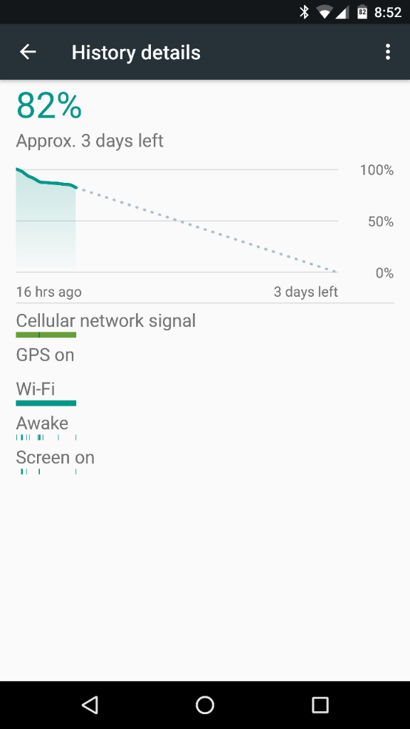

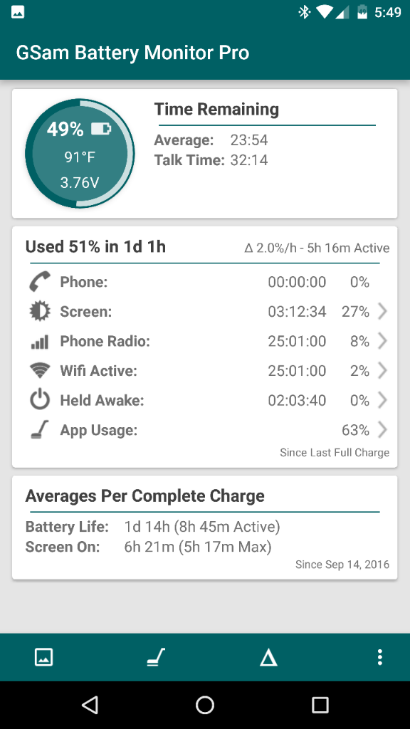

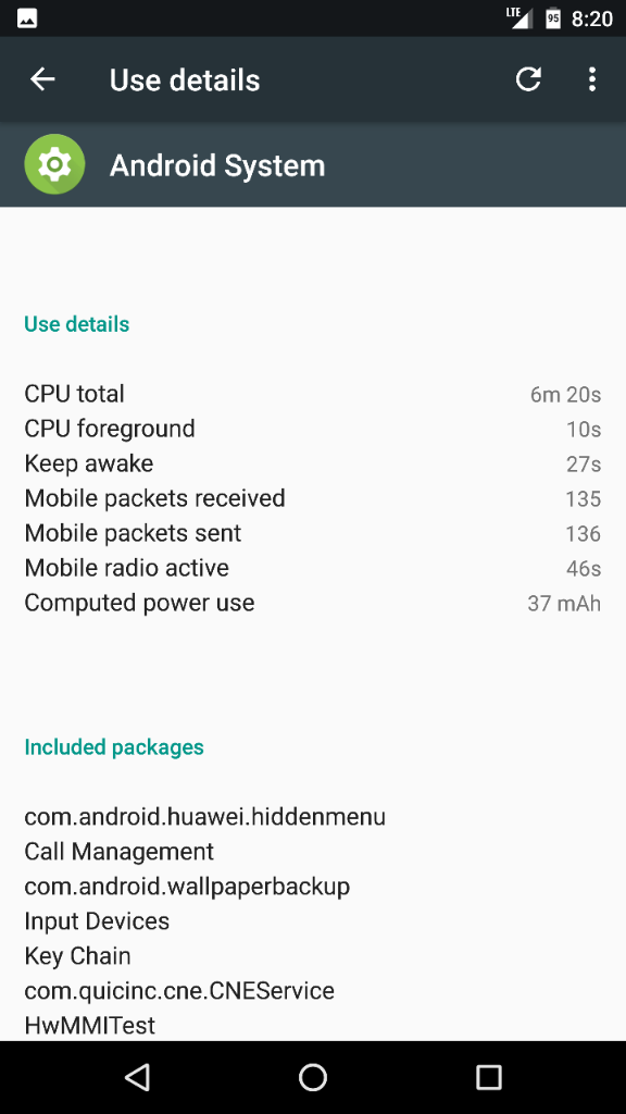

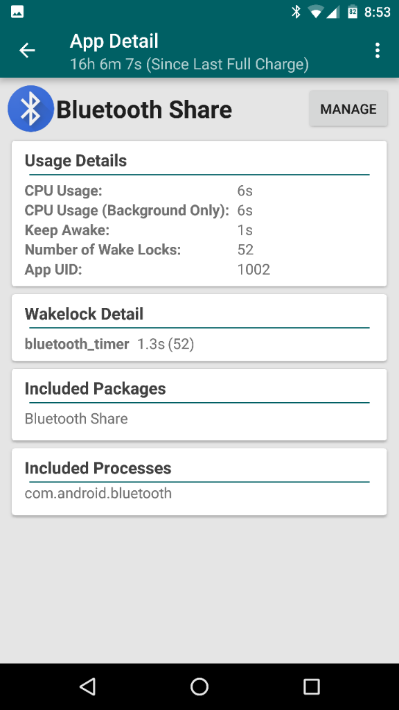

I'm going to have to disagree with your assessment. To check your assumption I fully charged the phone (to reset the Battery data), turned off WiFi, turned Bluetooth on and connected to a speaker, then disconnected the power and let music play for a half-an-hour or so (using my mobile data to stream) - as you can see in the screenshots there's no WiFi data listed, so it's clear that Bluetooth data is not being tracked here.
I'm going to have to disagree with your assessment. To check your assumption I fully charged the phone (to reset the Battery data), turned off WiFi, turned Bluetooth on and connected to a speaker, then disconnected the power and let music play for a half-an-hour or so (using my mobile data to stream) - as you can see in the screenshots there's no WiFi data listed, so it's clear that Bluetooth data is not being tracked here.//uploads.tapatalk-cdn.com/20160927/b4441e95e9878a8c9ddc116d61edbc75.jpg
My "Android OS" process (must be many, I'd guess processes, rolled-up) has 4812/3434 for WiFi packets received/sent, for a similar test, although I didn't do a direct Bluetooth drain like this, I just had my Mynt device on, and my PC set up for sync (just contacts automatically, it "should" only sync other if initiate it, which I do because I have a Qi charger filling up USB port;-]). This was for 18 hours of running.
If I turn off BT, my "Android OS" WiFi packets goes to zero, or very close to it.

Regardless of whether or not my BT packets are tracked this way, my "Android OS" process is at the top of the heap, in terms of battery use, every time, if I have BT left on, with no actual foreground BT usage (such as you did with music). If I turn BT off, "Android OS" drops to the very bottom, it's very relational, if not causal.
