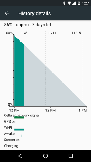

If doze is working, the graph should be fairly flat for the time it was asleep. You want to see the awake time and screen on time around the same amount. If you are not and your battery is draining a lot without using it, start with what was said earlier in the thread and go from there. Or post some screenshots of your app usage and times of the battery stats.

While the lines aren't flat, because it is showing about a day of use and the bottom of the graph goes out about a week, this might give you an idea. I took this screen shot on a weekend with very light use:
That's really tough to say. How long had the phone been on for already in this screenshot?
Somewhere around 24 hours, with about 15 or so minutes of screen on time.
Hmm it doesn't seem terrible to be honest with you. There's also things like cell/wifi radio signal and strength that I don't know about that may affect the battery drain too.

No, I posted it to show what Doze could do. Based on what was estimated, I was looking at 8 days (though with very low usage) before having to recharge the battery.
