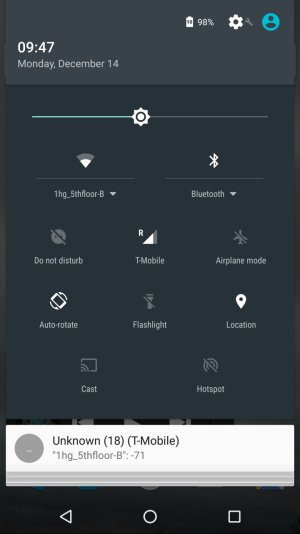

Drop down menu should also look like this

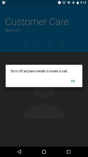

Connected to my home WiFi. Disconnects when I put airplane mode on then I turn it back on and get this.

I don't know what to tell you. After reconnecting to my home WiFi network while in Airplane Mode , I can dial a call. The phone app displays "WiFi Call" and T-Mobile customer care answers the call. I surmise that your N6P dialer isn't detecting an active WiFi connection. Are you using the Google phone app/dialer? Is the WiFi calling feature turned on?

So, now I'm really confused. I bought signal check pro to verify that I'm getting LTE while traveling abroad, turns out I am. Well, I noticed that when I switched wifi on this morning, my LTE signal on the SCP widget disappeared and it went to wifi only yet I still have signal bars and can make a call. This tells me that I'm running on wifi calling, but when I pull down the top bar, it still shows tmobile, not wifi, under the cellular indicator. Also, I still can't make calls while on airplane mode with wifi running, so thats a concern.
Are there any apps out there that can verify wifi calling during an active conversation? If not, I'm going to do a few test calls and then hit up tmobile to see if they can verify what I was using during those calls.
Careful! LTE doesn't mean that you're not getting a mobile signal! It means you're not using mobile DATA (which is why it goes away when you turn on WiFi). BUT if you don't see the WiFi Calling legend when placing a call, that call is being placed on the normal network with potential roaming charges (which is why you have that 'R' on top of the signal indicator).

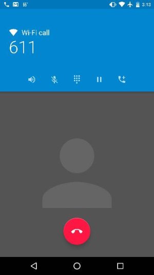

just tried it myself. wifi calling works in airplane mode. dialed 611 and it says wifi calling. this is useful for traveling overseas to make sure I'm using wifi calling instead roaming locally.
